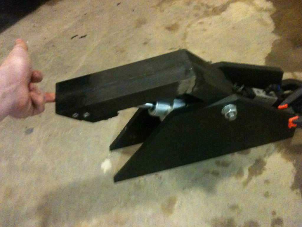

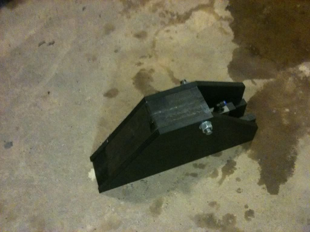

    I thought I'd go for something different to the rest but I give up, I'll just use the same parts for a flipper like this:
    It won't be the most powerful as I didn't make the ram that big as before I wanted lots of hits but it should be powerful enough to flip over other bots

    I'm guessing it would be forward hinged being mounted like that?
  10. #10
    Max's Avatar
    Member
    Quote Originally Posted by razerdave View Post
    That's an interesting idea, hadn't considered that! I was planning rear hinge though- should give lots of power to start with then a fast velocity once it gets moving.
