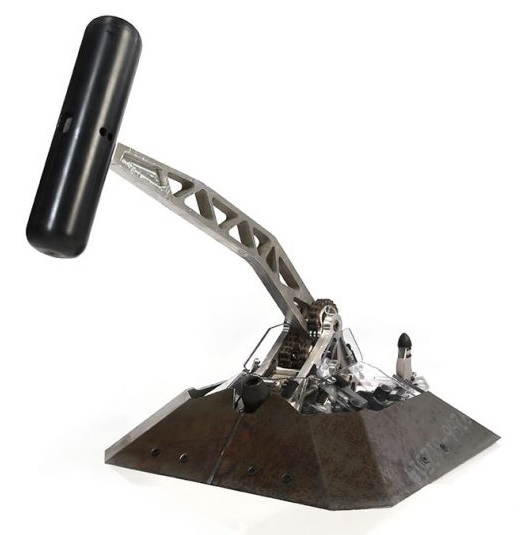

You could always try thinner hardox. 5mm is really quite thick for a featherweight, especially all over. Carbide has 5mm hardox side armour and a 3mm raex base, and that's a heavyweight.
