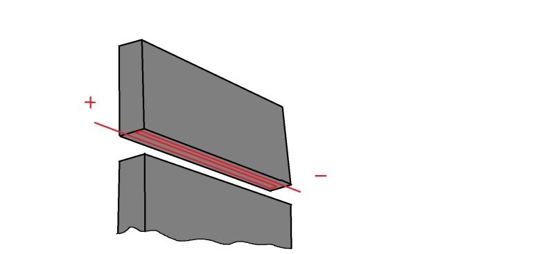

been looking ways to attach hdpe together and from what I can understand, the best method apart from fasteners is welding. I've got no plastic welding equipment so I'll try to fiddle with what I have - my idea is to pass a small gauge wire in the ends to be welded, then press the ends together and connect the wires to a battery, the wire should get hot enough to melt/weld the ends in theory. Anyone tried something similar with some success? I'll give it a go tomorrow and see what happens :roll:

Maybe give it a go. I think you'll find a blow torch more effective. Although DIY plastic welding is better for repairs than structural joints.
Possibly using tongue and grove joints would be stronger; or just mitre and bolt the corners.

Actualy, the wire idea is being used in industrial piping welding processes. But that requires some expensive machines. It's ment to weld tubes and connections together.
The tool I used was a combination machine. A mirror welder but with attachments for wire-welding.
For mirror welding (the mirror is a polished stainless steel plate). Put the tubes in the hydraulic clamps. Scan the barcode of the parts. The parts get pressed at a certain pressure against the mirror. The mirror gets heated to a certain temperature. When the parts have the temperature desired, the mirror is withdrawn, and the clamps press the parts together. Never seen neater butt-joints.
Wire welding requires elbows and straight connection pieces with the wire in them. But the idea is about the same. Push the cleaned parts together, align. Push the wire-connectors from the machine on the studs on the parts, scan the bar code, and press start. When the buzzer sounds, it's ready.
On HDPE welding equipment. After a few failed attempts with cheaper hot air guns and self build nozzles I got myself a second handLeister Triac S. Still not cheap.... But worth the investment. As the Hannibalito's demonstrate.
Re: Liftoff (FW) build diary
I have tried welding with this method before, the joint is always very weak. A routed joint and bolts is the best way. If you want to try the welding, for best results place your wire (very fine gauge) with 3mm spacing across the whole joint. This then will be the same as spacing on the pipe joins (hdpe gas pipe)
