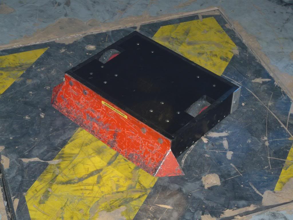

right then, update time again....
Well, what can I say? What a cracking weekend at the Gadget Show live and what an unexpected and destructive (+ a bit controversial) set of fights there were too. Well done to all the winners, Tom with Wedgie for the Gladiator, Alex with Tiny Toon for the Annihilator, Team Beast for the 1st + 2nd and of course Ellis for his magnificent 3rd place. That really was the biggest shock (pleasing) of the event for me :D
Any way, in terms of Endeavour's efforts, Meh.... not too bad. Didn't do too badly in the main comp, lost its first fight by being flipped out by Explosion within the first 30 seconds or so. We then had Killer Joule and Devils Coach Horse, we got 4 points from this as Joule got beached and then DCH got beached after we bent their front scoop. Our 3rd fight was against Defector and Massacre. We knocked Massacres link out and then won the match on a judges decision to get 3 points. Lastly we had our fight against NST and Keizer. We were doing really well and taking the hits like a tank, and then we got spun off into the pit by an NST hit, so only got 1 point from that fight. I think we could have taken more hits but yeah, that ain't gona happen when you're in the pit. Over all then we got 9 points, one off from qualifying which is the exactly the same as we got last year :'( Some pics of the bot below:
