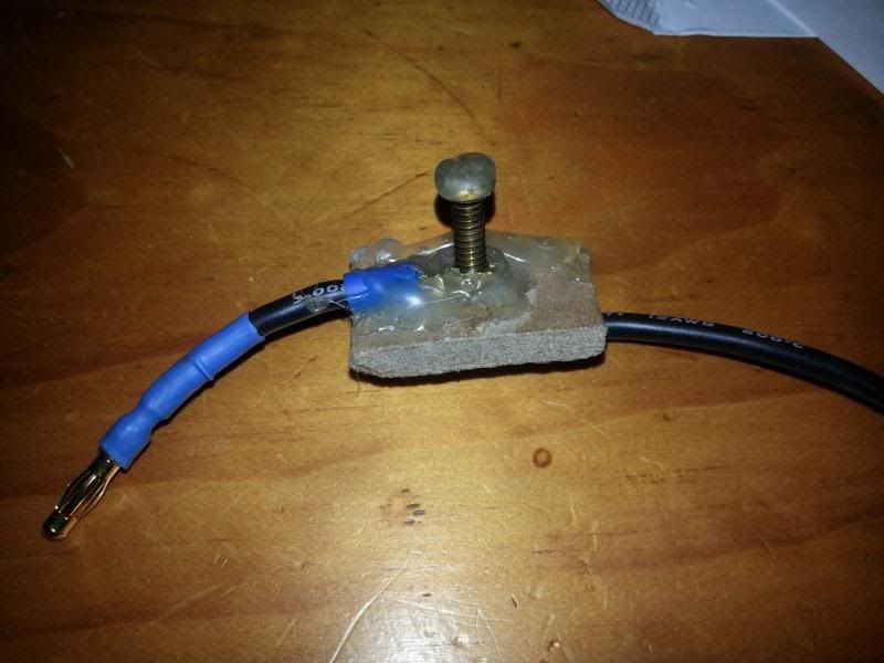

Brass nuts soldered onto ring connectors and then hot glued onto either side of an isulator (heavy duty cardboard in this case). Add the brass screw to turn the robot on. At out Australian competitions I only half unwind the screw, plus a few extra turns, to turn the robot off (main power light turns off, receiver light turns off, cooling fans turn off, we all know when it's turned off), but I guess in Europe you can remove the screw completely. Doesn't need to be hot glue, could be epoxy or cast urethane, but I'm broke and only had hot glue. Cheap, easy to make, takes a high current, won't shake loose and easy to put in a less exposed part. Only need to get the screw though a hole, not a whole link.
