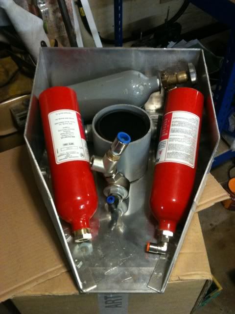

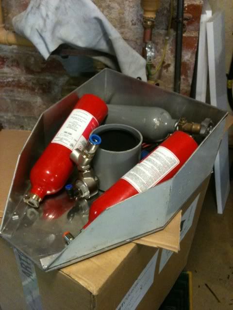

I've been at the metal workers today working on a new aluminium chassis for my rebuild of my fw lp flipper.
Here are some photos of the chassis with some of the main components placed in:
http://i1261.photobucket.com/albums/...t/cebfa0cd.jpg
http://i1261.photobucket.com/albums/...t/c7e97834.jpg
The next job is to get the ram sorted, the body is being made and I am Going to my pneumatic supllier friend soon to make the piston.
What's the thickness of the sides? It's looking good, will the wheels be exposed.?After looking Dave's new offering and NST, I'm thinking of moving to steel :)
Sides are 3mm aluminium, base is 5mm sides are stronger because they have been bent at the base to make a angle for bolting it to the base and the sides are bent around the base if you see what I mean. The wheels will be exposed but I won enter it in spinner events.
what are the buffer tanks?
